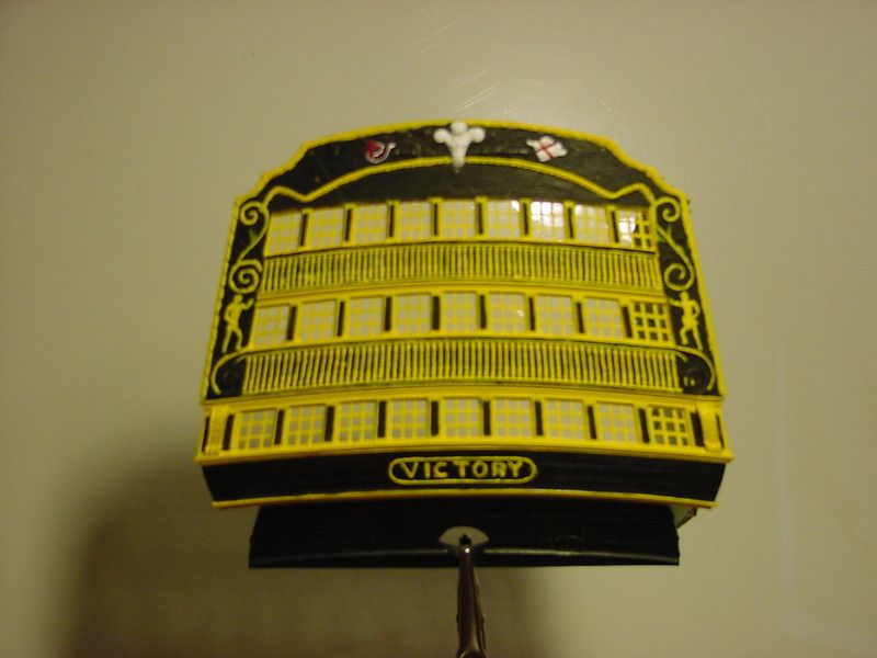

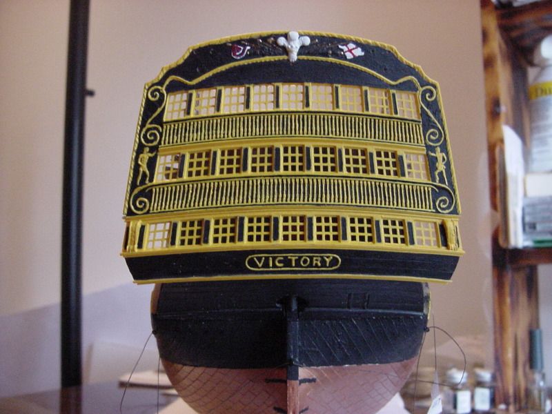

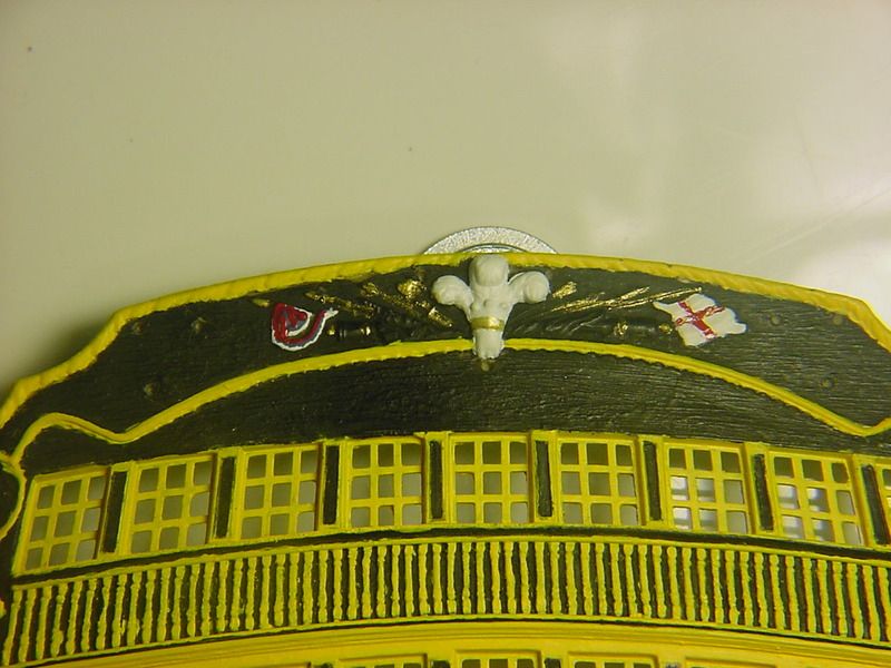

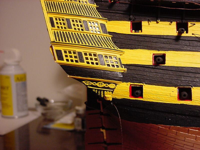

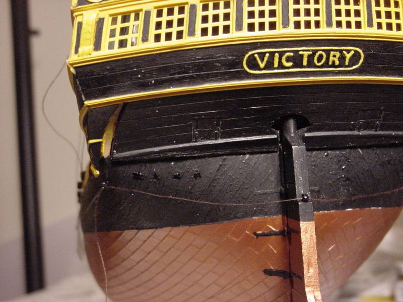

Hip hip hooray!! Finally finished (quit?) painting the stern & side galleries, and have installed the stern gallery in place (as well as the poop deck, and the last remaining rigging parts). So finally, I can move on to step 10! (Which involves more painting).
So here are some pictures; I hope I get the right URL from Photobucket (it's been a while since I did this!!):
This is a (relative) close-up of the stern gallery:
And here's a close-up of the "decoration" at the top of the gallery. This picture was taken through my magnifying lamp, and before I tried to paint some of the finer detail with some gold paint:
Here's the stern gallery & side galleries laid side-by-side:
Here's a side gallery taped to the stern gallery, just to give an idea of the size:
This is a view from the interior, after the window panes have been glued in place. A note to the wise: the long center panes that are glued to the stern gallery have very little wiggle-room, in the left-to-right direction. So it's imperative you do a test fit before gluing, so that you know where exactly to place the pane on its corresponding ledge. The same holds true for the side window panes on the stern. For the side galleries, the panes aren't bowed to match the gallery, so you actually have 2 attachment points - the left and right upright part of the window panes.

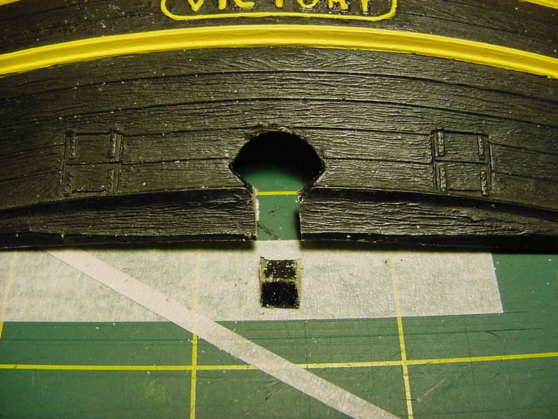

Here's the little piece I had to cut out of the stern gallery, so I could make it fit around the rudder post:
Here's a close-up of the detailing at the top of the stern gallery. Painting the gold band on the white thing wasn't too hard, but trying to paint the arrow shafts & stuff was close to impossible; so, it is, what it is.
Et voila! The stern gallery attached to the hull.
In the end, I didn't paint all the curly-cue filigree on the gallery; if I tried, I'd never finish this thing. I did the best I could painting the name on the gallery; in the end, I used a felt tip marker (a very fine marker!) to cover-up any slop from the yellow paint. And once again, Heller's molds need some work: the figure on the left of the gallery has his feet well defined in relief; the figure on the right, his leg/foot ends before it touches the ledge. So some liberties were taken in painting this piece.
Thanks for watching, and hopefully, the next update won't be so long in coming!!

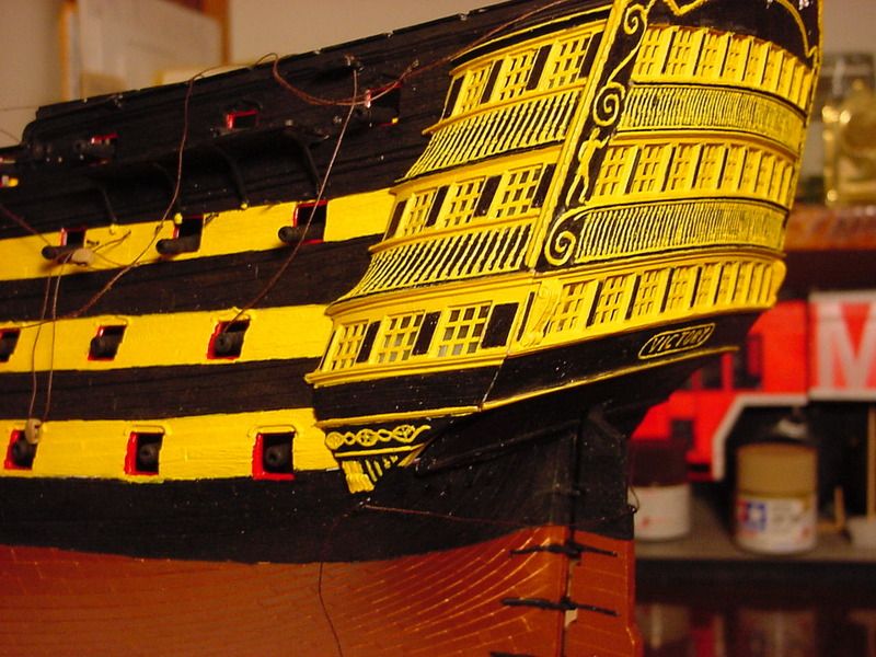

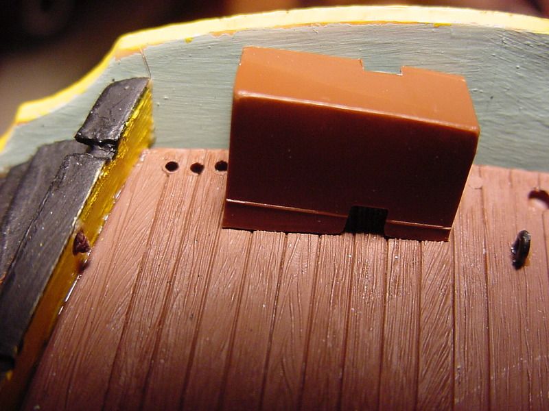

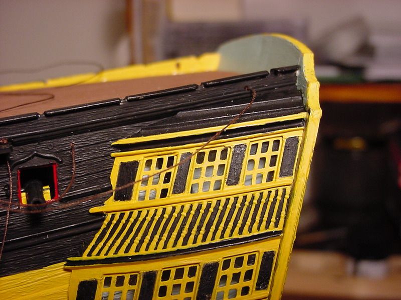

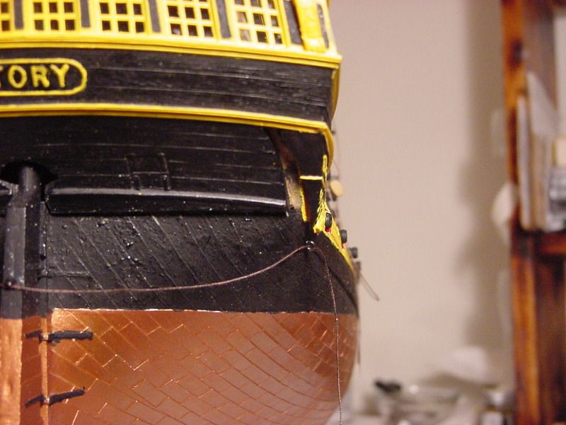

Posted: Saturday, May 21, 2016 - 06:39 AM UTC
Hello from soggy northern Virginia!

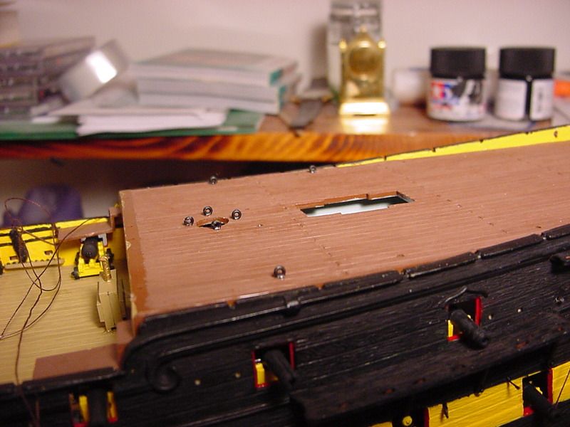

Well, just when I thought it was safe to put the paint brushes away, along comes some more of that insane detail painting on the port and starboard galleries. To wit, there are a couple of small parts that finish up the galleries on the bottom, and while small parts, still had some detailed painting. Here's a pic of the port part attached to the gallery (it's the very bottom piece)...and this is a view from the port stern
And here is a shot from the starboard side:
And here's a couple of pictures from the stern, showing how things (don't really) fit together:
So here again is a pic of the port gallery. The thing is, I though these galleries would fit all the way to match the height of the railing; they fell short by about a quarter of an inch, so this pic just shows that I painted the hull from the top of the gallery to the rail black; previously, it was colored the M1 (or M2? whatever the white/green mixture is, and was used to paint the cabin interiors).
This picture illustrates a bit of conundrum: what color to paint the area of part 351 (the stern gallery) that overhang past the hull, but is not covered by the port gallery? I'm thinking of painting it black, up to the hull, just to match the hull & gallery top. I think, too, I'll check Lockridge's book, to see if there are any reference photos, as well as another reference book, that has a few photos in it. The area that is between the hull will be painted yellow, to match the hull color that is on the inside of the hull.
This picture shows what I will paint yellow, to match the inside of the hull. However, there are several parts that are glued onto the deck, and onto the stern gallery. The question for me is, where do I not paint the gallery, so that those other parts can be glued against the gallery?
And the answer can be seen in this picture. Using my table lamp to illuminate the gallery, you can see some engravings on the gallery. The brown box that is in place, covers some of the engraving, which is there to help place those parts (I think they're parts 144 - 147). Things will be a tight fit, but the box (I think it's a signal flag box) and parts 144 - 147 are all painted yellow, so I don't have to worry about splashing yellow paint on things that shouldn't be splashed with yellow paint!

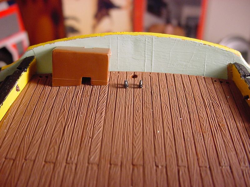

This picture is just a close-up of the signal flag box. The 3 holes in the deck are for some rings that are to be attached. I decided to hold off on putting those rings in, as I felt it would be better to paint the stern gallery before the rings get attached. There are 3 rings on the starboard side, too. (So that accounts for 6 of the 15 rings that are attached in this step).
And here's a pic of 7 other rings that have been attached. From the instructions, it's pretty hard to tell exactly where the rings go, but by looking at the holes in the deck, and looking at the instructions, you get a good idea of where they should go.
So tomorrow calls for a good chance of rain, so I'll have another day to play around. Hopefully I can do some post again tomorrow or Monday.
As always, thanks for watching, and stay tuned for more!

That's some very nice and impressive painting!!
It's a shame that the parts aren't really fitting, I hope you are finding some smart solutions to overcome those issues - it a really impressive build so far!!
Cheers,
Jan
Cheers,
Jan
timmyp
Posted: Saturday, May 21, 2016 - 11:38 PM UTC
Thanks, Jan. I never really expected the parts to fit perfectly together. I had entertained thoughts of filling all the gaps with putty, but given the time & effort & re-painting that would require, I'm just going with what it is. Besides, the gaps and such aren't that big, nothing that would be noticed at first blush. Of course, the real skill is in finding ways to cover all those gaps without working at it!!
timmyp
Posted: Saturday, May 21, 2016 - 11:42 PM UTC
Thanks, Jyrki. How's everything coming along on your build? I'm guessing you got that spreadsheet - I didn't hear one way or another from you.
I re-read the instructions about those threads you were asking about - yep, the instructions certainly say to have one of those blocks 200 mm from the hull. But you know, I went and looked at some pictures of the Victory, and I see that there is a big block that is pulled in close to the hull. I figure if the block isn't really where it's supposed to be, I'll just make the threads that go through it a bit longer.
Tim
